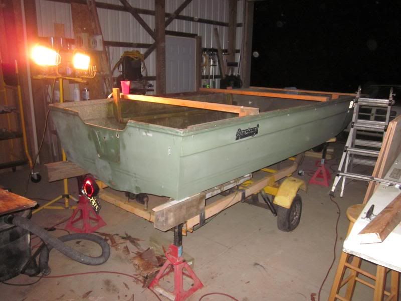

Ok here's some pics, I got my transom out tonight in one piece for a template. Took about an hour with the cap, stringers, and inner fiberglass skin already removed. It was water logged but not rotten so I decided to replace it even after drying it out for the last 3 weeks or so. I replaced the middle stringer first for rigidity before removing the other two and the transom...
Simple tools...
Here she is...

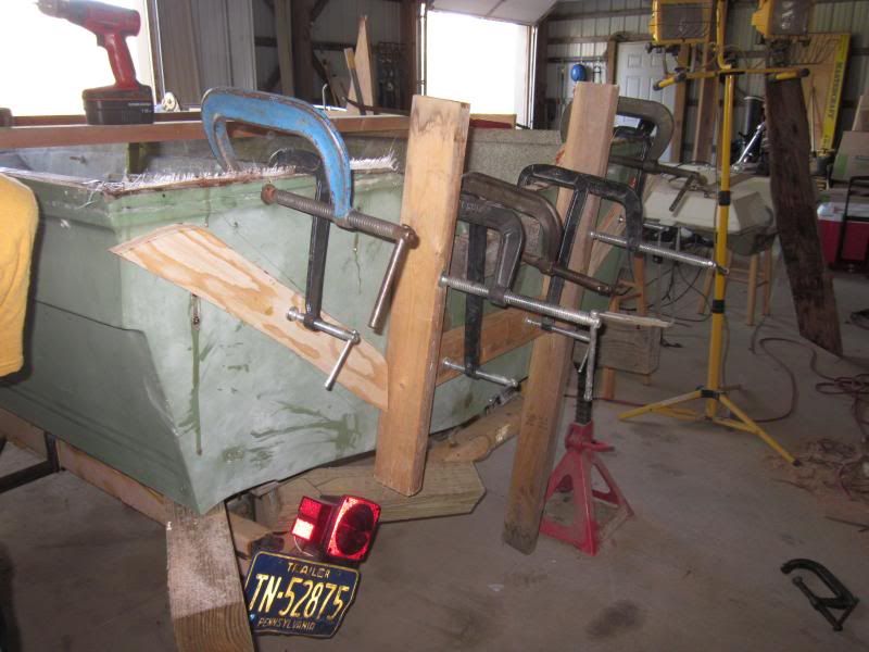

Bought some clamps, drilled out the rivet, flipped it all around and made "pusher" clamps...
Transom in...

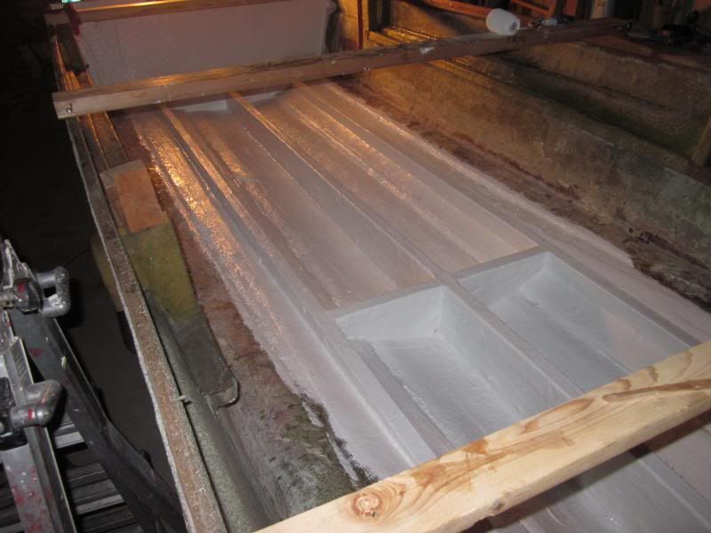

First coat of Duraplate 235 after sanding everything down. The forward bulkhead has 1/2" cpvc glassed in the lower corners to drain water into the forward bilge. I bought two 7"x11" hatches from iboats for access panels (to be installed)
Another coat, flotation foam and hope to knock out the deck this week! I have one heck of a supportive wife!
