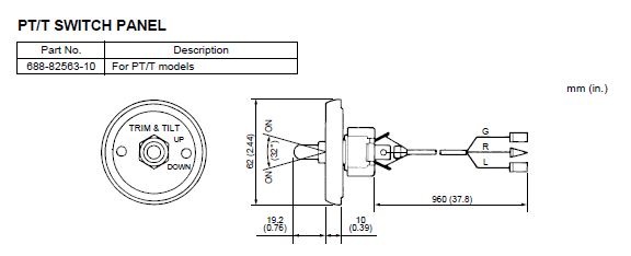

After doing further research, I found that I needed two additional harness’ to hookup the gauges! I’m almost there now, but still need a bit of clarification! There are two separate pigtails coming from the controller, each with a red, blue, and green! These merge, with red to red, blue to blue, and green to green ending in 3 female bullet connectors! These wires appear to me to be for power and the tnt! If this is correct, here lies my confusion; looking at the 10 pin diagram for the engine harness, does the harness not already include tnt, with the switch on the controller handle? Can you clarify this for me! Am I close or way off base? Thanks!

Some boaters want a third set of tilt and trim controls. Yamaha offers an optional switch that can be mounted at say the front of the boat. A harness runs from the switch to the extra leads coming from the 703 control box.
