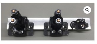

arks
Nov 7, 2002
1,967
You gotta find the solenoids. They are there somewhere, and as alldodge and Ted mentioned, should be within a foot or so of the windlass itself.
Here is a picture of a typical solenoid panel, showing both solenoids and the circuit breaker. Maybe this will help. Good luck!IMG_0279.jpeg
Here is a picture of a typical solenoid panel, showing both solenoids and the circuit breaker. Maybe this will help. Good luck!View attachment 417393
I think its likely at this point that my system doesnt have solenoids. I can see where the thick wires go from the motor for at least 6ft and theres nothing there. I hear the click at the motor so my plan is to take the motor off, and test with the switch. If the switch makes the motor turn both ways, i'll know its the gears that are bound up. I hear it click at the motor though when i try to go down, it just doesnt do anything. the actual entire gypsey assemmbly nudges too like it wants to, so i dont think its the solenoid at this point.
