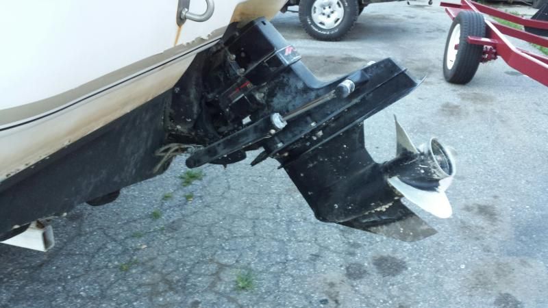

just got back from checking out the $3k wellcraft. boat is alot bigger then i was expecting, but its exactly what the wife wants (she was with me) the exterior is very clean, much cleaner then i was expecting. the floor felt very solid, the motor ran well and the guy was straight up about everything, he has a bunch of speed boats and whatnot. we spent a good hour going over all the little things that we saw on the boat. now onto some pics and what it needs.
the exhaust bellow is completely ripped in half, the big bellow above it has a crack, the third one is in perfect shape. (he told me this on the phone, i dont mind replacing them) the drive fluid reservoir on the engine (top right reservoir when looking at the engine) was empty, setting off the alarm, not to sure where its leaking at. its a closed loop cooling system and got to 170-180 and seemed to hold there. all the gauges work except the tach, the needle is broken off. i checked all the storage compartments everywhere and everything was straight, floors felt perfect, i stepped on every spot possible, except the ski tunnel.....there was 1 questionable spot. but for a $3k boat i cant expect it to be perfect. also the seats are pretty beat up, i also new this going into it, i dont mind doing new seats.
also, the guy said it has a newer version of the 4.3 in it, as he said its got the updated crank sensor in it
here are a few pics i took
this is the questionable spot. it was the only spot on the boat i could find like this. everything else was solid. it was on the starboard side, about 2/3 of the way into the tunnel

I would be worried about the u-joint bellows having a crack in it in the Wellcraft. I would have the drive pulled to see if there was water in the bellows.

Any way to get an ice pick or screw driver into that fiberglass void on the Wellcraft? That way you could feel if the wood is soft, etc.

Based on the photos of delaminating wood and the stream of rot goo along with the description of torn bellows, empty reservoir, bad interior and a soft spot, you will be pulling the Welcraft apart in 5 months, not 5 years. It has been neglected PERIOD. its a $1000 boat that needs $4000 worth of work. dont walk from it, run to the car, get in the car and speed away at 90mph.
Turbo read this one again.^^^^
You cannot water test, bellows in that bad of condition are not a good sign and you REALLY want to pull off the sterndrive and see whats in there etc etc.

Mechanically: When you redo the u-joint bellow, don't get discouraged. It is a doable job, but it is a biotch! God created boating. The devil created the job of changing bellows. It sucks. I just did mine not long ago. I'd rather pull the engine than replace the bellows. The exhaust bellow if it doesn't reattach it the back, it doesn't matter, so don't worry about that one. Get the hinge pin tool, you'll need it (ebay).
Please do this though: The outdrive is likely out of oil because the U-joint bellow leaked and got it may have gotten water past the seal. I've read that the seal is to keep the oil out, maybe not so much keep the water out from the bellows side. So, you may have some chewed up upper gears in the outdrive. If so, it is not the end of the world, you can find them for about $250 on craigslist.. or a new one from SEI (Sterndrive engineering) for like $700. But, pull the cap off of the top of the outdrive, it will make for an easy inspection of those gears...especially since the outdrive lost its oil. There is a special socket for it..10 pin? 12 pin? something like that.
Wow! How did you come up with that? There may be water in there and that is why I suggested to have the drive pulled but oil draining out because of it is pretty far fetched at this pint.

I've seen water in the U-joint bellow affect the seals in the upper portion of the outdrive. If water intrudes into the outdrive and dilutes the oil, then there can be problems. And, if the seals get blown out, the outdrive oil can leak out. I'm not really saying that is what happened. What my point, although not real clear, was is that the outdrive has no oil, so the upper gears should be inspected and that it isn't that hard to inspect them - 4 bolts and pry that top cap off. My discussion of the leaking bellow was just my trying to figure out why the outdrive oil leaked out.
Anyway, this post is an example of what I'm talking about:
http://forums.iboats.com/forum/engi...-outdrives/323471-gear-oil-in-u-joint-bellows
