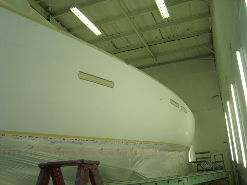

I totally agree with you .. 2 part is more expensive but its worth it in the long run.
The time invested prepping a boat for paint should be equivalent to the cost of the paint itself.
It took 2 weeks to prep and only 3 hours to spray this boat.
It took 4 days of sanding and buffing to get this ..
This is a Dead on shot of the hull reflection ( not some angle shot ).

You should also consider your own skill level.
What your seeing in the pics are by a Pro like me and others that have experience with the nature of paint and tools/materials and how they work.
Please do not make the mistake of just looking at a few pics along with products used and expect the same outcome when you go and do it.
Its not a Recipe for perfection at all. Sure we can give you the ingredients .. but the outcome is very much different from person to person/skill level to skill level.
Not saying you Cant get a perfect job from a roll and tip. I personally know a husband/wife team that can roll and tip Awl Grip like GLASS .. I mean Glass! It can be done but that couple has been doing it for 20 years.
I know you may be under a budget. I would contact Woody for his one pac paint job and how to apply it with satisfactory results. Remember though.. you probably will not get the same results on your first run.
