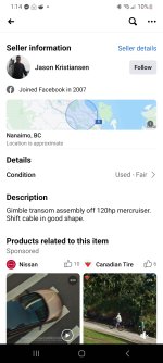

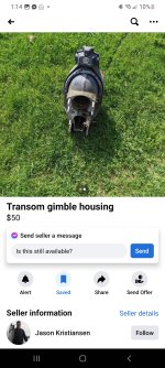

Next question would this unit work with my alpha 1 gen 1?
