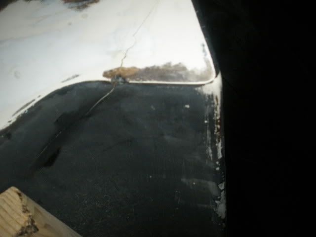

Re: Upon Further Review..#$%@..1973 Slickcraft Trans/String Overhaul
Whoa there! Lets consider one other option before the wrecking ball comes out!
IF, and I say IF because I'm not there looking at the boat....
IF the bond around the perimeter of the transom is GOOD, then why not cut the inside section of the skin off, clean up the transom, and then reglue the skin back on? Really, the strength is going to be from the outer edges of the transom and the transom itself, not the skin around the outdrive hole. That's merely there for its good looks. If you can pry around that area and remove it, then square it off and cut the skin off from around the outdrive hole to the point where you got voids. There are plenty of transoms removed and replaced from the outside in...if you leave the curvature of the corners of the hull intact, along with a healthy sized tab, then all you'll end up having to do is grind a nice taper off either side of your cut and then do some glasswork. Lots easier than pulling that transom out, and you can ensure the bond between the outer skin and the transom itself.
I mean, hell, it's IN PLACE and not moving. It SOUNDS to me that you just aren't comfortable with the outer skins contact with the transom itself.
You have LESS to REDO, if you do it this way, vs trying to remove the transom itself, and it will still be plenty strong. If you have concerns about the transom transmitting force to the rest of the hull, you can always reinforce it with more glass.
