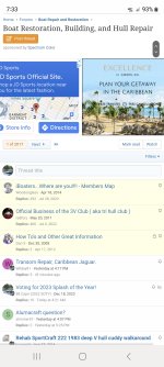

In the restoration forum at the top where it says "How tos...."
52,901
Hey Scott, not sure what you mean by stickies?
I’m new to the forum and currently using on the phone.
Will that make a difference?
Put your phone on desktop mode.
Every forum has threads stuck at the top like post-it notes. Hence the term "sticky"
