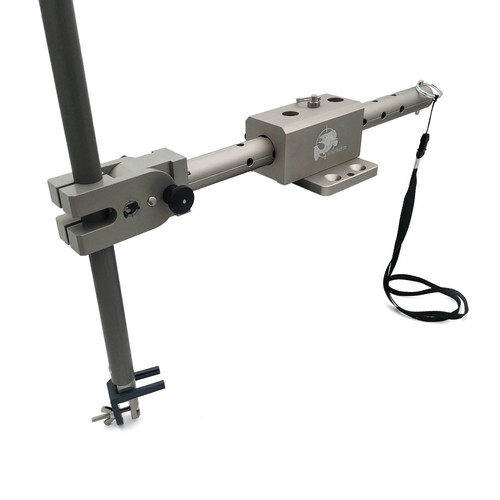

Buddy mounts his transducer on a telescopic pole he can retract
52,851
Made himself. Two pieces of aluminum tube, some aluminum plate and some time in the shop

52,851
my bud used a 1.5 x 1.5 aluminum tube with 3/16 wall and a 1 x 1 aluminum tube with 3/16 wall.
the outer tube had a mounting flange welded to it so he could bolt to the aft fence
the inner tube had the transducer mounting plate welded to it, and a stop at the top.
the inner tube had a hole drilled thru near the top
there were 2 holes drilled in the inner tube (two different heights) and he used a small quick pin to keep in place in the water or raise up as needed.
since then he welded a mounting bracket behind one of the tubes

Use these for ideas to fabricate.
