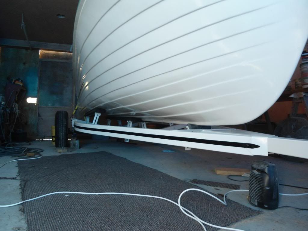

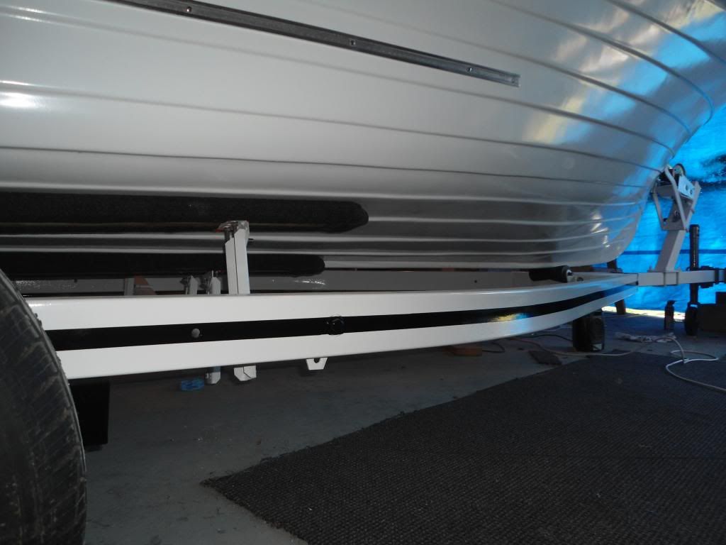

FF , I was also thinking the bunks are a bit high . I have never used an all bunk trailer so was not quiet sure how to set it up . If I lower the stern it will ride bow up . It has to rest on the front roller unless I add some other type bunks . The keel is pretty much parallel with the trailer now . Ya think it would make a difference if it rode bow high . Here are some more pics . Do you think I should place the center bunks on the next strake out from the keel ?
bruceb58
Mar 5, 2006
30,787
Re: Time to start trailer rehab
If you could somehow figure out where the stringers in the hull are, I would try to place them there if you can.
That is a very nice looking boat by the way.
Just admiring your almost completed project. Nice work.
When viewed from the side your bunks do appear high. When viewed in the image above, I don't see how you could go any lower. It is impossible to tell from a picture how far back that first keel roller is. If it is more that a couple of feet I would be tempted to add one closer the front of the boat for those few time you hit the pothole from hell. You don't want that nice bow to hit that steel right where the tongue starts. And those suckers can a do break sometimes.
The only thing I can suggest is to bulk up those bunk brackets big time with some 4 or even 6 inch channel the height of them is probably as low as your gonna get without the keel hitting the trailer frame and maybe by moving both sets of bunks out and making them longer to spread the weight over a longer distance will help along with increasing the angle of the brackets inward! (sketch it up 1st before fab)

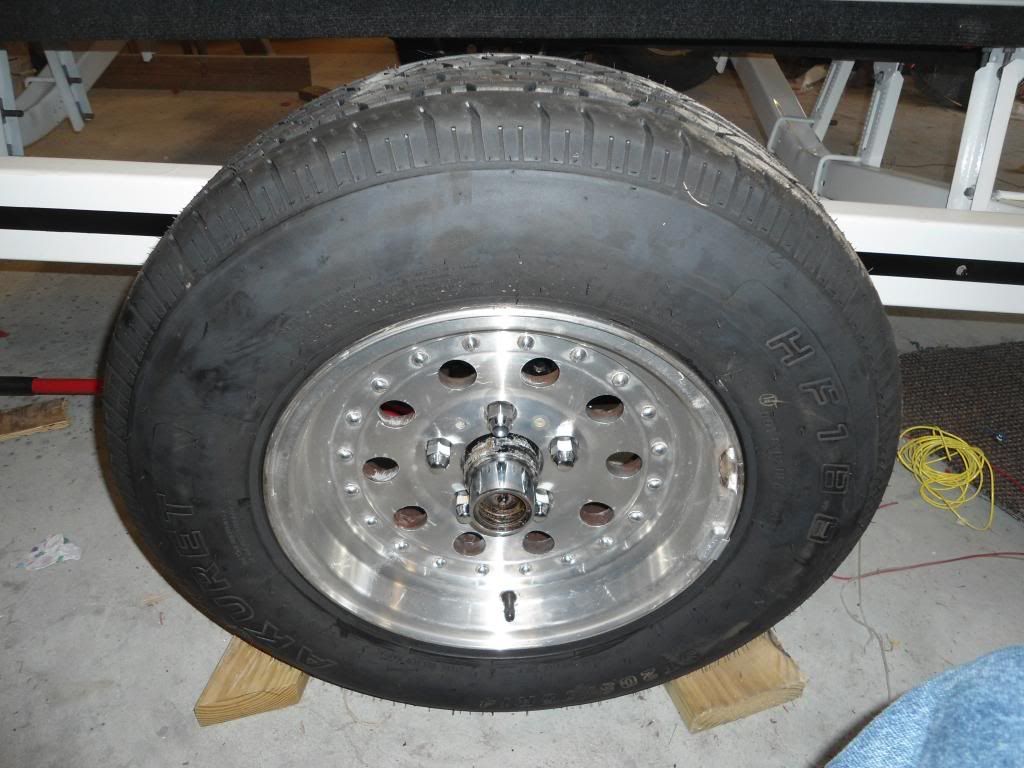

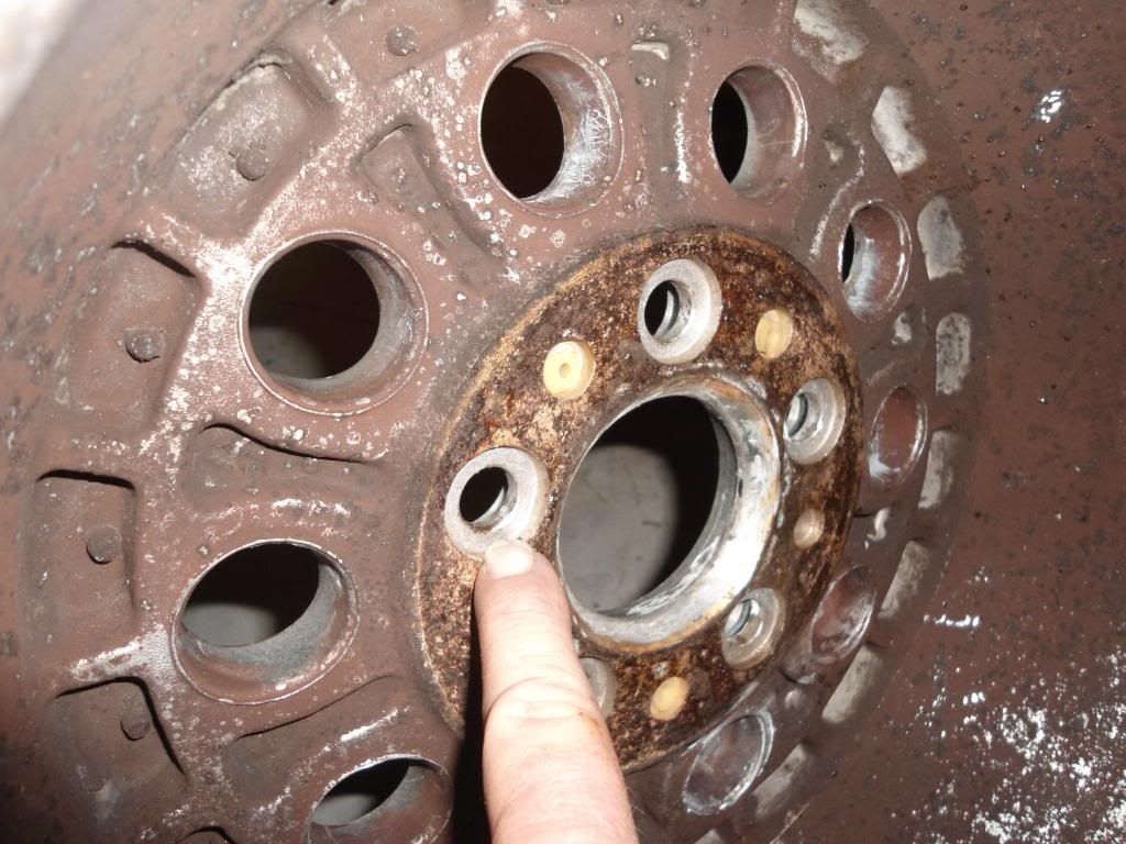

OK I have a question . Hopefully someone can shed some light . I picked these rims up at a junkyard . They came off a Ford Ranger pichup.
20 bucks a rim .
There is a recess on the inside of the luggnut hole . Should there be a washer of some sort to fill this space or do you think it will be fine without ..
Thanks guys !
Out of curiosity, how close are you to the max weight of your axle? Sometimes auto wheels aren't rated to the same load as a trailer wheel because an auto wheel has an offset.
sphelps
Nov 16, 2011
11,508
I,m not sure what the axle is rated for . I know there was a much larger boat than mine on the trailer when I bought it . How can I confirm the rating . I am guessing the weight of my boat at around 1500 lbs maybe . Not sure until I weigh it .. I would hate to think I can,t use these rims .
bruceb58
Mar 5, 2006
30,787
if its only 1500, you should be fine.
Cindy's boat
Recruit
Jun 11, 2012
To answer your question about the rims. The recess is there to allow space for the keepers that hold the rotors and drums on the hubs. No spacers or washers needed. Nice job on the boat and trailer. Cindy's boat is still in a snow bank waiting for summer to arrive. Daryll (The other half of Cindy's boat. LOL)
