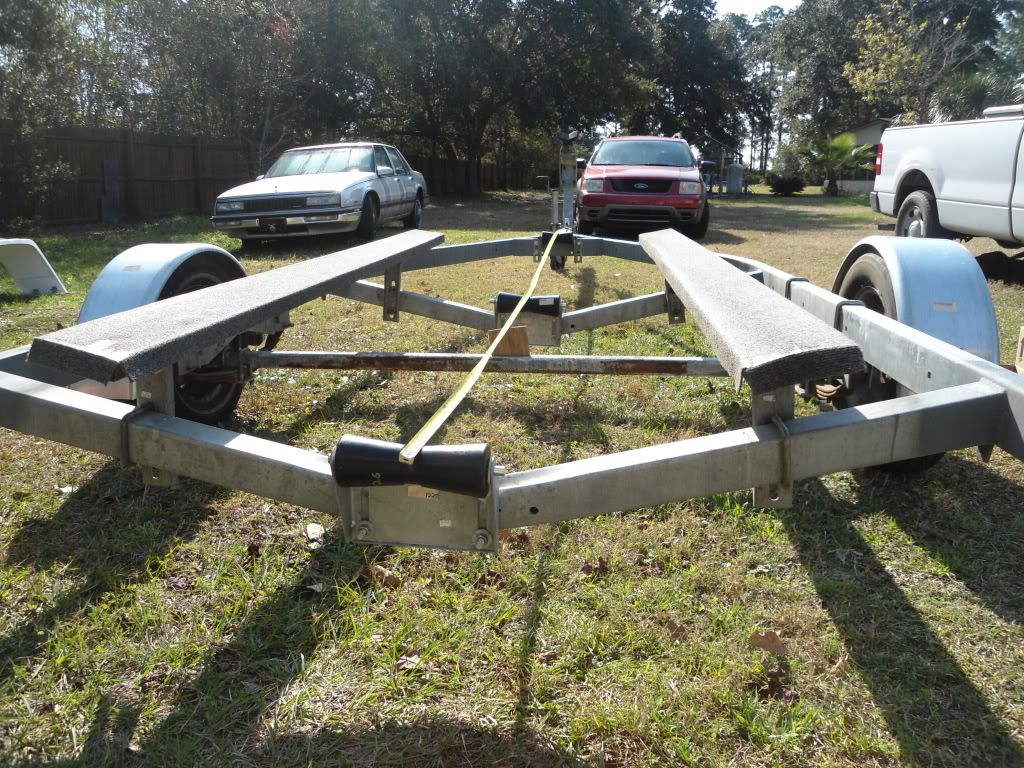

Welp I pulled the trigger on this one . 350 bucks I think an ok deal . He through in 2 new rollers and galv fenders .
May be a tad bigger than I need but way better than I had . Did I do ok ?

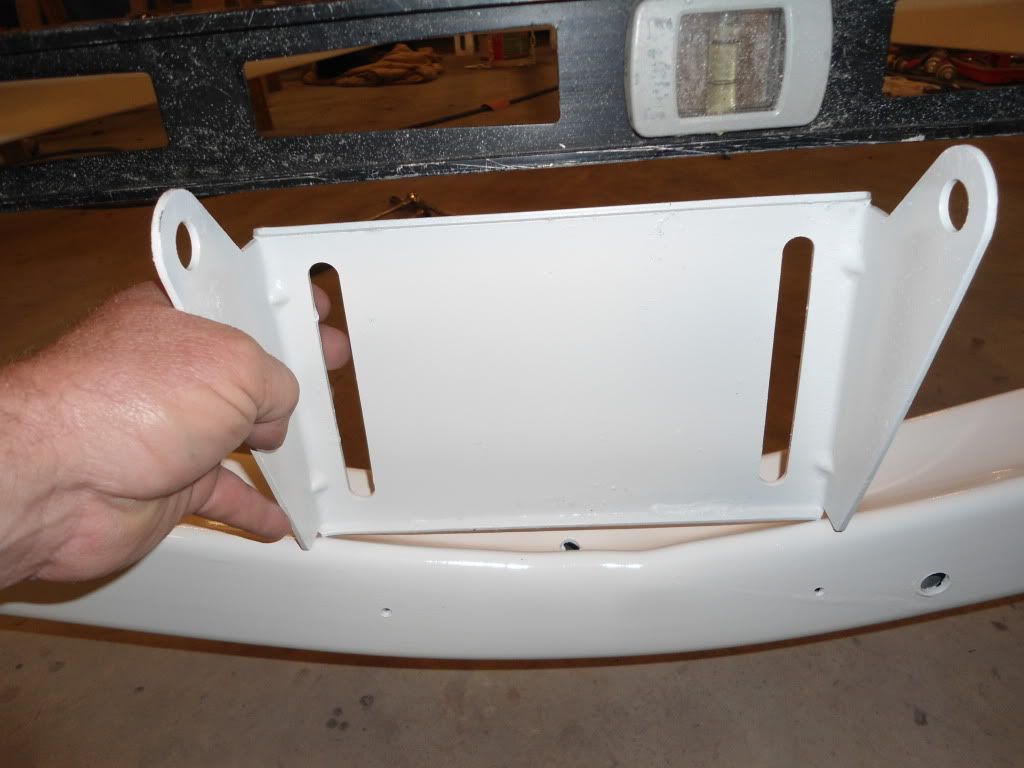

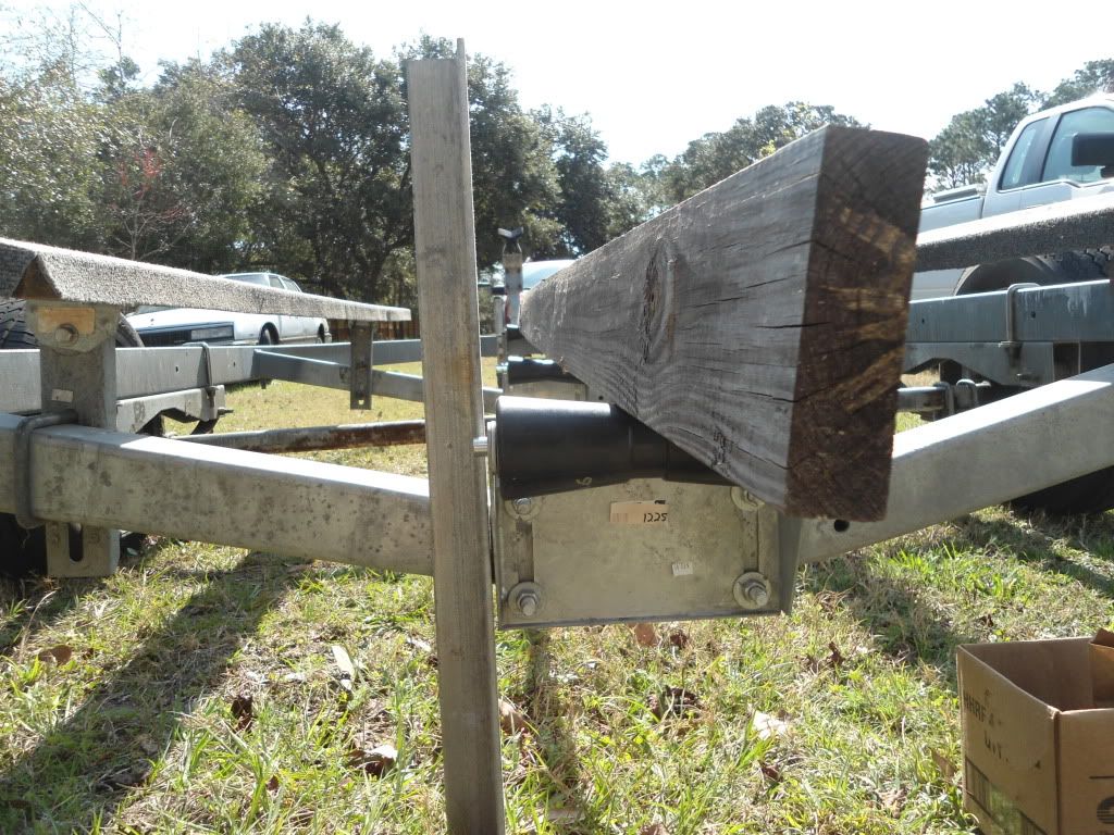

Ok I need some opinions . Here is the trailer with rollers . I don't think I can raise the rollers high enough without adding some type of support angle to bolt it to . Should I just go with all bunks ? I like the idea of rollers but if it doesn't work then I guess I can adjust to using bunks . How would you guys set this up keeping in mind the lapstrake hull I have .
Also adjusting the winch post back to fit the boat I will have approximately 4 to 5 ft of tongue in front of the post . Do you think that will be a problem ?
Thanks for your input ! SP..

Here is another idea . I can raise the roller height with some vertical angle . U-bolt angle to frame then thru bolt roller bracket to angle . Or just use angle for the bracket .
I really don't have much adjustment on the very front roller so the rollers will have to be raised to make it sit level ..

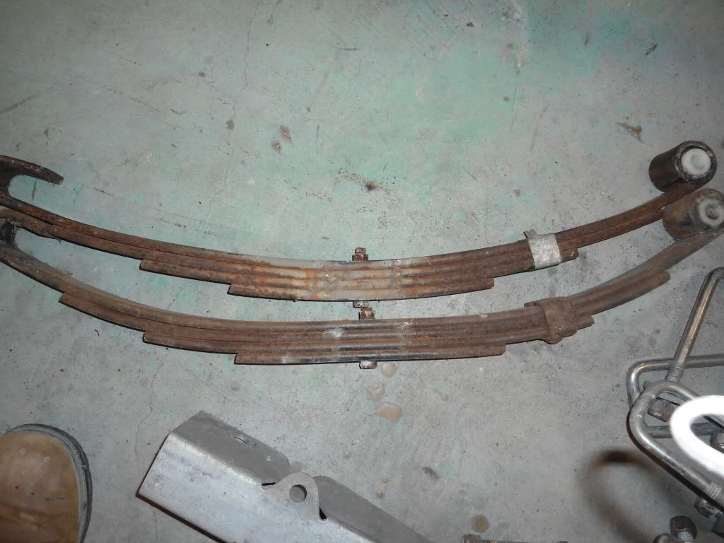

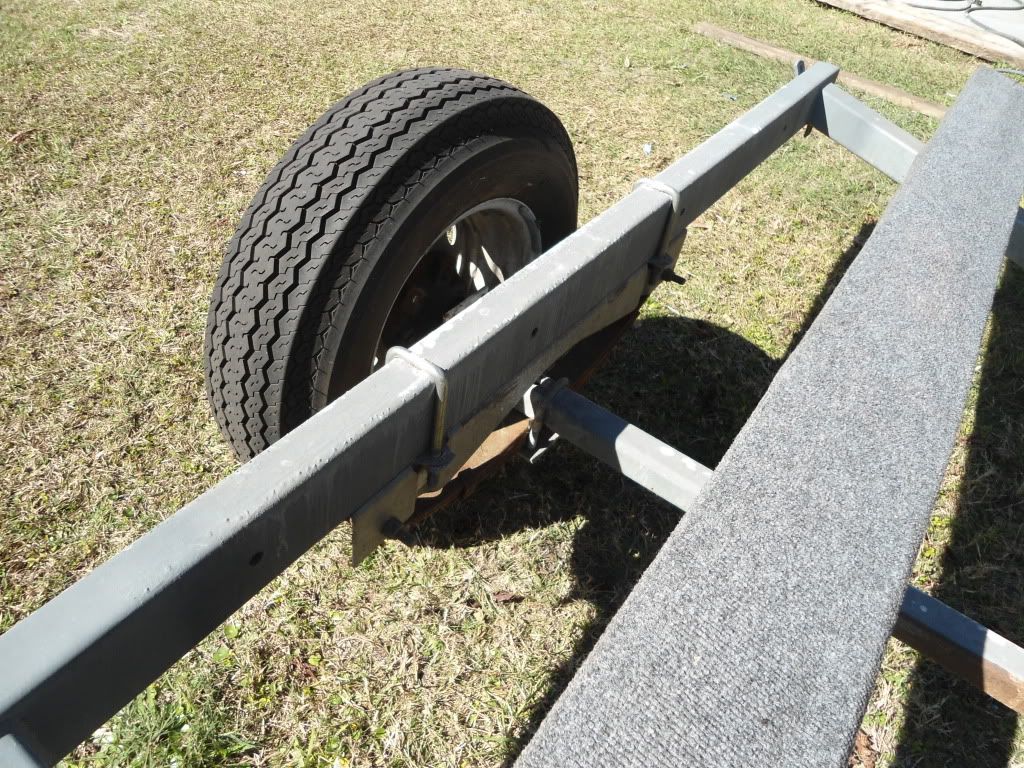

Is this a problem ? The spring on the bottom appears to be a little bent or flat compared to the top one .

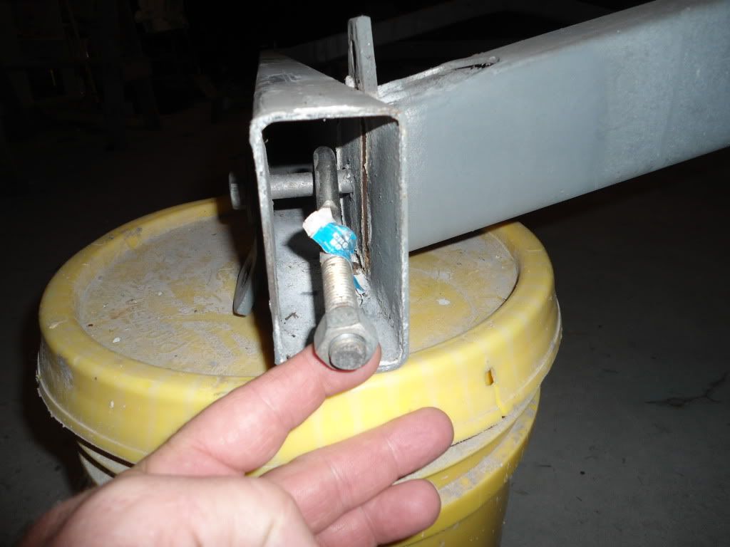

Also the po installed these threaded eye bolts on the ends of the trailer frame . Have any clue what they are for or what I could use them for ?

The threaded eye bolts have been used for the transom tie downs to keep the straps from rubbing or wrapping around the transom when the boat ends up all the way back.
Also to hold the end caps on, but they were 1/4-20 thread not the 3/8 or 1/2 you have.
hope that helps

Thanks huts ! That makes since . I will look around and see if I can find some end caps ..

I assume that the keel rollers ,if I go with them , need to all be horizontally on the same plane .
Should I give up on the idea and stay with bunks only . I would have to jack the roller brackets up somehow on the middle and back support bars . Otherwise the boat would sit bow high and look kinda silly .
Any thoughts would be greatly appreciated .
Probably too late to the party, but if it were mine I wouldn't trust the lower spring since it looks like it was over-stressed. I broke a leaf spring on a utility trailer full of concrete chunks, no fun at all trying to get that off the road at the time. (strapped and braced wood blocks between the axle and trailer frame and drove very slowly to get it all home where I later replaced the springs on both sides.)
But I'm no expert so listen to someone else.

Thanks Treebound you are the only one that responded to this ? It seems to be taking the weight of the boat ok but I will look at it again when I install the motor . I guess the safe thing would be to replace it ..
