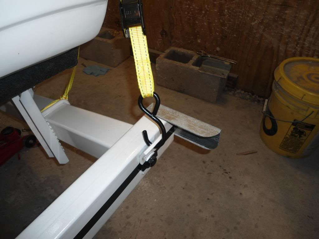

sorry i didnt go to the second page i was on first page. those eye bolts you said po put on there they hold a flat metal plate and then the lights are mounted to that plate. and it holds your license plate also. wish i had a picture to post for you
sphelps
Nov 16, 2011
11,508
Re: Time to start trailer rehab
OK that makes sense .. It was also suggested that you can mount a set of eye rings to it for transom straps . Maybe a plate that will do both . I wonder if I can find something pre-made . If not I guess I could fab it myself ..

I use the hook things on the side of the trailer to put strap over boat. think 5x7 piece of thin steel would work for light brackets. I looked on ez loaders web site and couldn't find brackets. I will try to take a picture of mine tomorrow so you can see how it looks and how they attached them

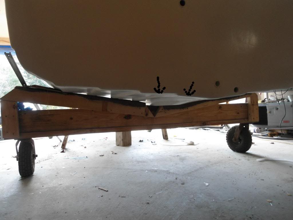

Here is my bunk set placement .
You guys think it will work ok ?

Will be interesting when you load your boat how often the keel happens to fall in that slot. Might be worthwhile launching in that configuration a few times and see how it works.
I was thinking the same thing . I think if I install some guides on the sides maybe it will fall in the slot . Or jump to one side or the other and really tick me off ! LOL ! :pout::mmph::doh::eek:hwell:

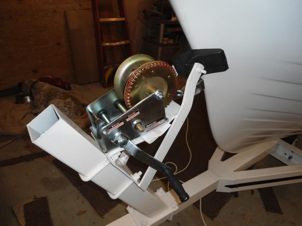

Here is my winch set up . I picked up a 2500 lbs rated one from N/Tool . 2000 lbs rated strap . Probably a little bigger than I need but I needed one wide enough so the handle would clear the mounting plate on the post ..
And no I did,t get my fingers stuck in the gears . I put some left over axle grease on them .. :lol:

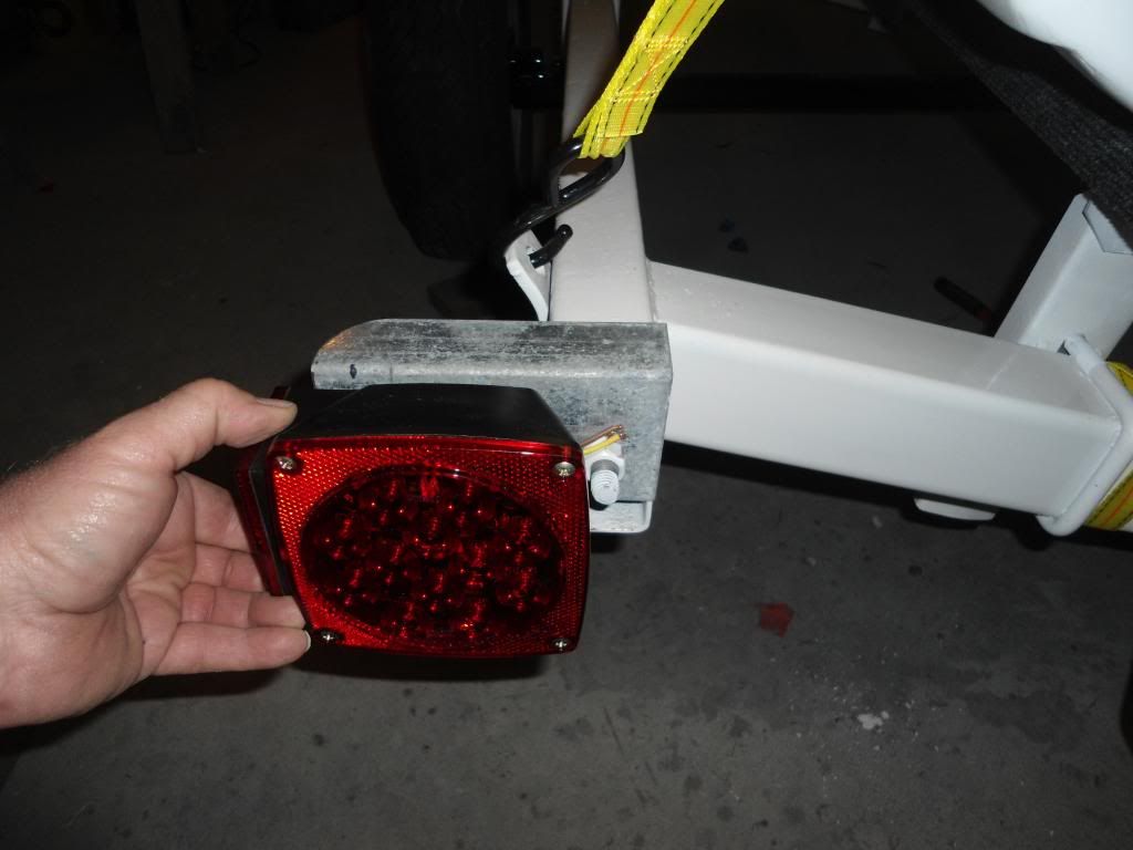

Here is my plan for mounting the lights . I cut a piece of 12 ga galvanized angle and will bolt it on using the eyebolt the po installed .
As you can see it was small enough to leave a gap at the bottom for feeding wires and drainage .
I assume I should ground the lights to the frame and not the add on angle .

Looks awesome Sphelps. better than factory:joyous:

Man those bunk brackets are pretty high I would suggest to get the boats center of gravity as low to the trailer as possible plus this will add a stability factor and make the bracket a weak point (they could bend over time from retrieving) I would also suggest spreading them out as wide as possible to help as others mentioned hitting the center of the trailer when loading. Also the rollers are to never touch the boat after being loaded onto trailer they are just for avoiding damage tot he keel when loading. Hope this helps and the trailer and rig look very nice!
