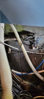

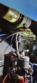

Hey, bought this boat, 1974 duo challenger 18 with a mercruiser 140 inboard engine. Not too familiar with the old girl so any help would be appreciated.
Is the tilt pump supposed to have a reservoir attached to the bottom? And also, what are the 2 pieces that are attached via hydraulic lines? TIA

Ayuh,..... Welcome Aboard,..... There's a screw in the top of the squarish section to add oil,.....
The other bits are a reverse lock, 'n trim indicator,...
