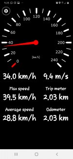

At 5K the motor will be running around its middle wot rpm range which it's excellent.. What like doing is propping right the motor to achieve max wot revs when solo boating lightly loaded. Once there keep testing with slight more passengers aboard till the motor reaches its middle wot rpm range to maintain a nice hole shot from a dead stop. This scenario will be my max passengers allowed for offshore, open water boating, sumo boaters can stay home or find another good samaritan to have fun with.
Is your current motor a manual or electric trim model ? if being manual does it sits trimed at 90 deg on transom? Have downloaded to my phone a nice multifunctional speedometer called : Jens Peterson Speedometer, check.
