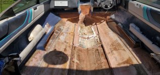

Got some time in today continuing the demo.
Spent another couple hours out there earlier in the day, then had to take an extended break due to a pretty wicked headache. Not sure if it was the sun, the restricted breathing from the PPE, or the fuel fumes.
Got back out a couple hours ago - the rear seat boxes are roughly 75% gone. Spent quite a bit of time sweeping as well, as we're expecting more rain over the next several days.
It was overall a slow day at the office. But I'm getting there, and I'm not ready to throw in the towel on bringing this zombie back from the dead.

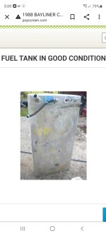

The picture I posted isn't mine but just showing the difference.
The changes I made so far were eliminating the ski locker. I did that to remove water intrusion areas, although it greatly reduces any storage on a boat this size. I have been contemplating incorporating storage in the front seat boxes since I now have additional floatation foam where the ski locker once occupied but this will be a future addition should I go that route.
