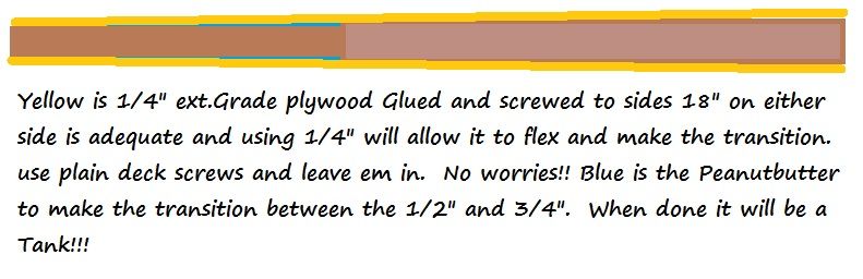

Ext grade Ply will work just fine. You can use the MG if you want but just saying it's NOT required. Once the Ext. Grade is properly encapsulated in resin and glass it will last for decades!!! I'd recommend using 3/4" and using Thickened resin, What we call "Peanut Butter", to make a smooth transition @ the Butt Joint. Again once it's glassed in it will be more than strong enuf. The fiberglass biaxial cloth is very strong. I've attached a drawing to show how I'd do it. Hope it helps. This is just how I'd do it and have seen others do it in the past with great results.

Thanks for the replys!!!! No I don't have any photos on me a the moment. Yes I do have the decking removed about 12 inches further than the where I stopped cutting out the rot. The old stringers were only glassed on one side and only about 3" up the side of the stringers. Is this normal? With the glass only going up about 3" up were the stringers really providing much strength or was it the hull that provided the strength and the stringers just support the floor? I was planning on encapsulating the stringers entirely. I have 1708 Biax tape I bought about 2 years ago that I will be using to glass the stringers in place.
