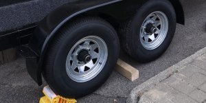

I was thinking of buying a spare wheel hub in case one bearing fails far from home.
Is it something that happens often? I grease my bearings twice a year.
Are there many models in the same manufacturer for the same capacity?
My axles are Dexters 6 bolts, 5000 or 52000 lb each, with a 6'' drop.
I want to make sure I buy the good part.
Here are some pictures of the axles I have if you guys know what they are.
PS: the spring leafs have been fixed since then.
