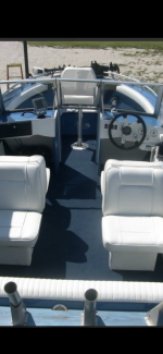

Any of you guys use a seat base this high?
I’m trying to figure out my V bench and seat mounting options. Ie; Deep footwell and tall seat post, or shallow footwell with a seat base on top of the bench. Worried that a short post on top will mean the seat position will feel cramped.
Any of you Super owner have fishing seats up front?
Anyone use a seat post this tall? I’m using the Springfield Taperlock series. I want to be sure it’s stable
Yes. Your photo looks like the standard "Wise" brand seat base. I'm reasonably happy with them (photo below from my initial test fit 3 years ago). I briefly considered cutting mine down as some guys have, but I don't spend that much time actually piloting the boat. On nicer days, I often sit directly on top of the two seat cushions for a clearer, unobstructed view. More than anything, a taller windshield would likely solve some of these boat's ergonomic issues. On the other hand, I like that it fits cleanly under my 80" garage door opening.

Hey look at that. This is exactly how mines going to look. Same colour patterns everything… thanks for posting the photo!
I think I asked my question poorly. I was referring to the swivel seat up in the bow section. It appears to be a very tall seat post that I can’t help wonder if it’s stable. Obviously not for sitting on while the boat is in high speed motion, only for when fishing with the trolling motor.
But I do the same thing that you do when I’m driving. (Sit on top of the sleeper seats)

I forgot who, but someone built a removable base that sits at the cushion level in the bow. That way you are up higher while fishing, and the post is average height. Although I have bow seating, I have a spot for a swivel chair up front as well on my “casting deck”. Either way I think you would be fine, but a backing plate should be used. I put a 1/8” plate behind my seat mount, sandwiching the casting deck floor. Extremely solid.
