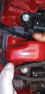

HI
There is a serial number engraved on the bloc :126 30 881 and 19 07 15 b0008 (see attached picture )
Do you think it can be a useful information ?

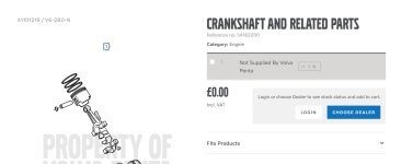

HI
Unfortunatally on the volvoshop, the segments are not supplied (see attached )and no delivery time is indicated. Even the local dealer , has no answer , that is why I am searching other equivalent on a similar VOLVO PENTA engine .
are you needing crank shaft parts and related?
Ayuh,..... If yer lookin' for internal parts, as Scott says, they are GM / Chevy parts,....
Not Volvo,.....

Not sure what the numbers are in yer picture, but the Block's serial number is stamped into the block's deck, starboard forward corner, right up close to the cylinder head,....
