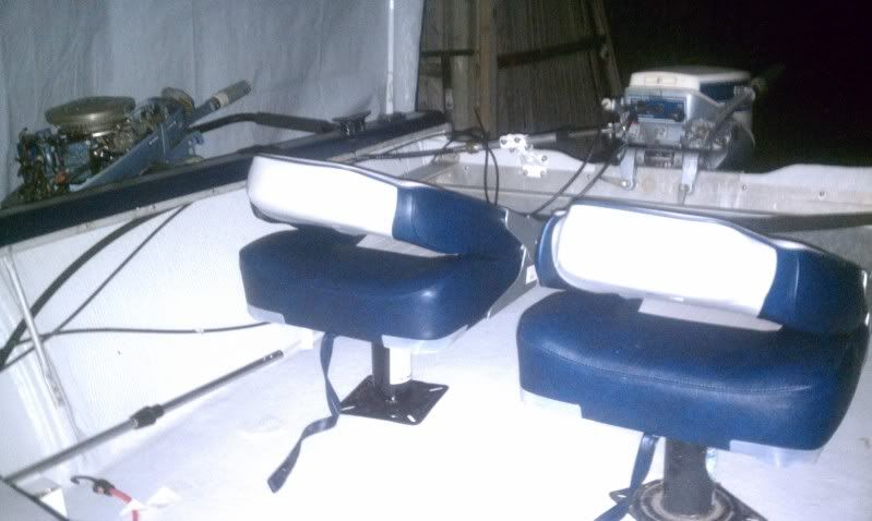

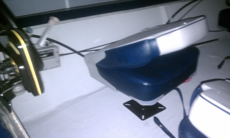

I am trying to mount the seats in my boat and i was going to use 7" pedistals because they seamed a good height. After sitting on them before mount i really think I am sitting way to high. Is there anything shorter than that maybe rails or something that was used back them? I am at a lose on what i should do.

Depends on how thick your seat cushion is etc. What kind of seat are you using?? Pics??

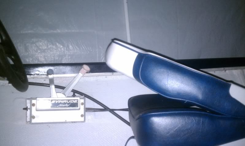

ok it is 8.5" to the bottom of the seat, the cushion is 3.5" and the distance from the floor to the top of the rail is 19"

Ok, Now I see. Yep I'd say you're about 4-5 Inches Two High.

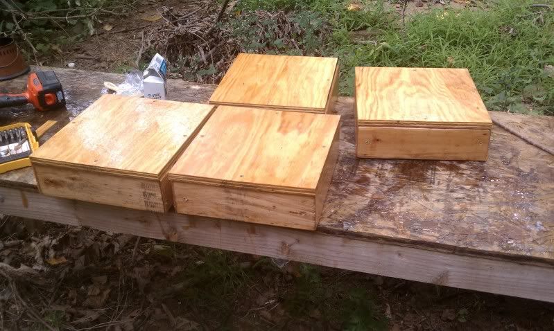

Or Make your Own pedestals or platforms and coat em with epoxy.

built my own, i think that is about as low as i can make them. they will end up being 5" instead of closer to 10"
