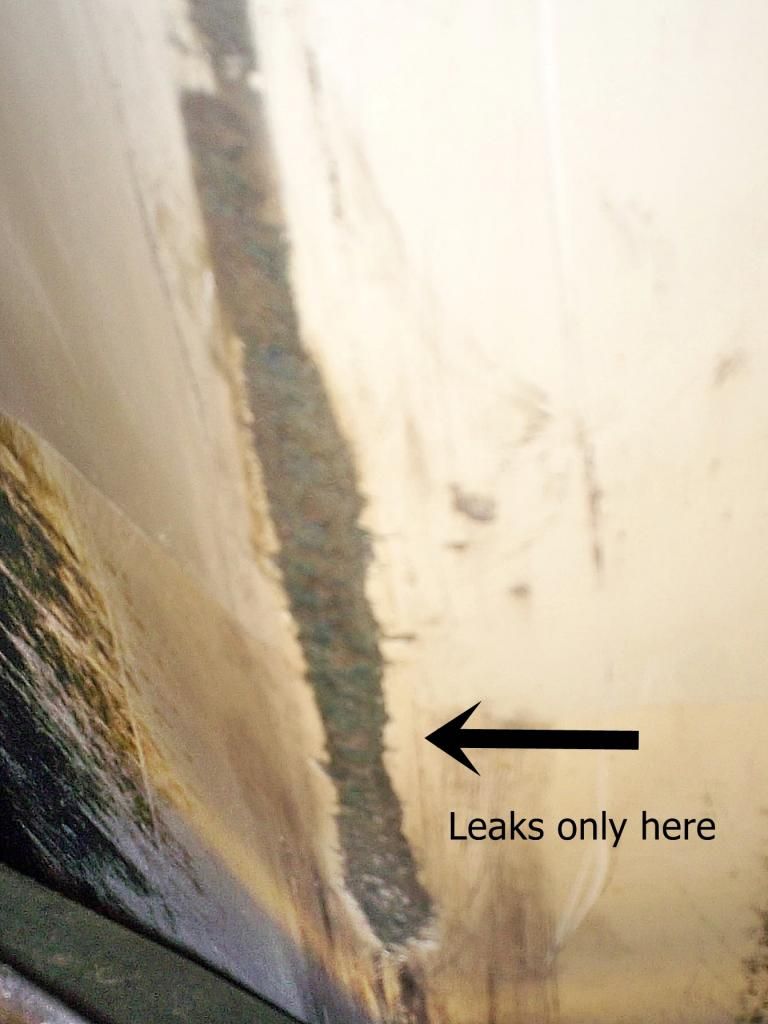

I was putting my 17' Boston Whaler on the the trailer when I heard a scraping sound on the trailer, so I backed the boat off, almost totally submerged the trailer and let the boat settle on as I pulled out. When I investigated, I noticed the middle roller on the trailer had disappeared (not sure how or even when) and the keel now has a scrape through the gel coat and it is showing fiberglass. Not very serious, no frayed edges even, just down to the first layer of glass. I let the boat sit for a week and went to repair it with some white Marine-Tex today.
BUT...
Water is leaking out through the scrape. It will actually build up and drip off over about a 10 minute period. I am at a loss as to what to do. I am guessing there is water in the foam and it is dripping from this low spot that now is open, but how to I repair the damage in the hull? (I really am not willing to tear up the floor at this time)

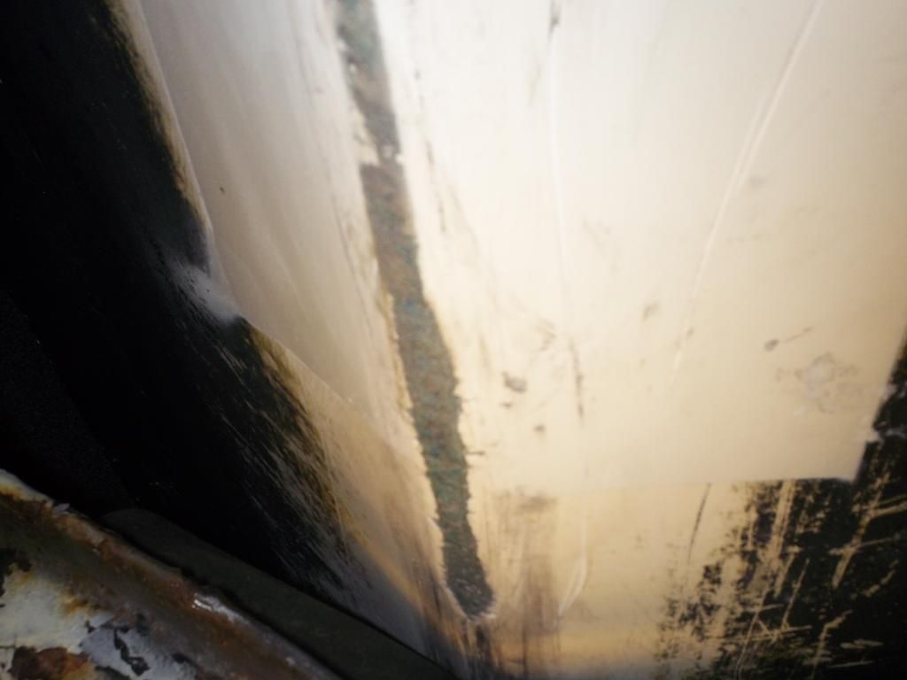

More notes:
I will be adding some photos.
This keel section was repaired in the past by a very reputable marina. (The prior owner had this done)
The water only forms a drip every 5 minutes.
The foam in various other areas I have checked seems dry.
I am not positive when this damage occurred, but it could have only seen about 10 hours of submersion.
I know gel coat will not stick to the Marine-Tex, this section of the keel is white and I am fine with using white Marine-Tex on it.

That patched area looks large and makes me wonder just exactly what was done to it.
Your arrow makes it look like the drip is coming from just behind the patch and I find that curious too.
If it was me, I'd drill 3 or 4 1/8" holes in the center of the keel scrape and see just how much water leaked out... You're going to have to patch that area anyway.
