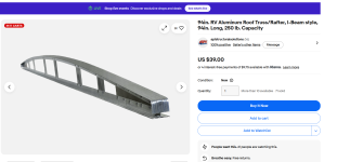

53,361
Aluminum stampings would have been lighter and about the same price, with a higher load capacity....
I know they make them because you can buy the replacements.
and you can find them with a google search. (this one is aluminum tube weldment)
I also have found fiberglass and injection molded reinforced plastic.

I guess it's what the manufacturer is used to using. Including retraining the labor. Sad.
That looks very strong. Researched my roof and the little info I found it sounds like I gave 5" wood trusses. The rest of the frame construction is aluminum. Of all places not to cheapen construction, the roof should be high on the list...
