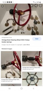

I have a 50s WageMaker wood runabout with a 57 18hp Evinrude fastwin outboard. Looking to set it up with rope pulley steering but I need to find a steering wheel with column but having trouble sourcing one. Looking for something like the attached. Send recommendations, thanks!

If you want to keep the cable and pulley steering, it will take a lot of Googling to find a helm with a cable drum.

I have made several of those arrangements. Use a 2" plastic expansion plug for schedule 40 pipe. 3- 1/4-20 bolts hold on the wheel and a bolt through the center through a wood mount for the boat. Pullies available at home center and use galvanized cable for a garage overhead door. Do not use stainless as it work hardens over time. A storm door spring and cable clamps while at the store. Use shrink wrap over the cable ends for sure.
I see now you need a long column but some of this might help...

Google is your friend. E-Bay has several vintage wheels with hubs for sale. Just pick your style. There are also several vendors there that sell the complete new kit of fasteners, pullys, springs and cable. Total cost for both about ~$200.
