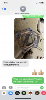

•Found 3 terrible JB Welds on:
-Block
-Exhaust Manifold

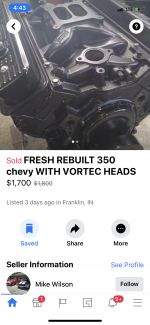

•Bought new Boat SBC 350 Crate Motor....

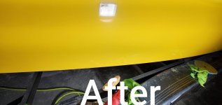

•Floor Painted(Hull): Bilge pump, engine area/surrounding, ski locker/new cooler painted yellow(for help with keeping it clean & also look great).😒❗️Ideas more than welcome!!

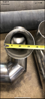

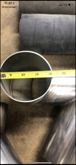

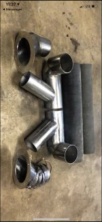

•New Side-Exhaust Installed:😒
-Come closer to time, may need help... I have pics of new exhaust❗️
