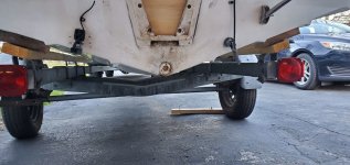

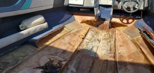

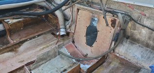

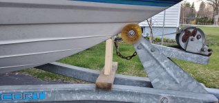

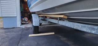

I have an I/O in my 1750 so the procedure for the transom may be different, I didn't need to remove the cap but did leave a very small ridge of glass from the old one for a guide to install the new one. (No more than 1/4") I still had alot more grinding to do after this picture was taken to get all mating surfaces clean.
I attached a picture of how I removed my seat boxes to replace the floor/stringers, I was able to remove them in one piece and reuse them due to no rot. Using a multi-tool was priceless.
I left my boat on the trailer but added a couple of blocks so it wasn't resting on the bunks, the last picture is showing how much room I had above the bunks with the blocks.
Okay, thank you those pictures are very helpful. I suppose just letting it rest on the bunks after taking the stringers out would deform the hull?

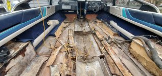

Well I worked on getting some of the foam out after work today for a little over an hour and feel like I made pretty good progress, probably won’t touch it again until this weekend because there is supposed to be some rain coming tomorrow and Thursday. Have a little more cutting to do, need to get the junk wood out of it and do some more foam removal. Also hoping to remove the engine this weekend tooIMG_1192.jpeg

Would you have still lifted yours off the boat if the bunks were under your stringers or is that even more reason to do so?
I would have lifted it either way because everything in the boat has a structural purpose and even though a cradle would have been best I had no way of doing so. The way I had to do it seemed to work well as I had no issues on the lake operational wise.
