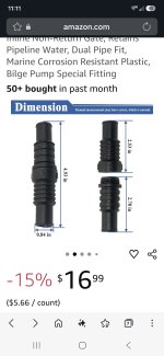

My cuddy was the same there was a step down toward the cabin. I laid a pvc drain down against the keel starting at the point in the bow where water would collect. Then at the edge of the stepdown where there was another spot water could collect I added a tee and another drain. Then out to the bilge. At this spot I added a one way check valve to keep the water in the bilge and not able to go back to front of the boat.20221104_195552.jpg20221104_195126.jpg20191021_214012-2268x3024.jpg20191021_213951-2268x3024.jpg20191029_110402-3024x2268.jpg Works well

Hey, thats a good idea with the check valve... might do that on mine.

I fit mine to slide into the pvc stubout in the bilge. Made it fit barely snug then added a o ring. Screwdriver to pry out and a long bar to pop back in due to accessibility.
