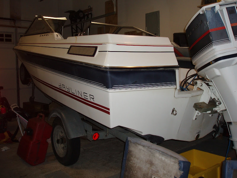

I am getting ready to do a little work on mine. Did you use Marine plywood on your floor? By the way you are doing a great job.
Many people speak of "marine" grade wood, and being a US Marine, I have to say, I don't know what wood they are talking about. LOL. Just kidding.
Jokes aside, it is recommended by many people to use marine grade wood, but that is generally for purposes where the wood will be exposed, like if you are crafting wood trim, or larger scope, a wooden boat like a canoe.
For purposes like this, it is important to use exterior grade wood, because the glue/wood combination is more suited to weather and changing climate. The only trick is to make sure to coat it thoroughly with resin, maybe even fiberglass too, to ensure no moisture gets into it. Once moisture finds its way in below the resin, it will expand, crack the resin, let more water in, cycle, cycle, etc... floor is rotted again.
All of the above is only my interpretation from speaking to some experienced people and doing some research. I am certainly no expert, but it is a fun project.
