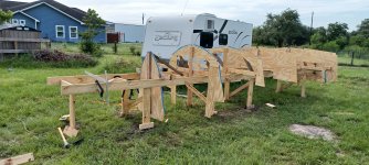

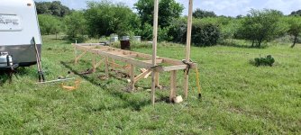

The pictures show one of the layout studies (probably not the final one, but Blender has been invaluable for turning 2D drawings into 3D models and figuring out where everything actually fits), the completed strongback, which deviated less than 1/2 inch over 24 feet, and the temporary frames assembled.
I’m actually finishing up the bulkheads and stringers now and getting ready to flip the hull upside down again for final fairing and painting. I’ll post those photos later.

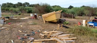

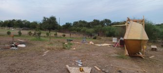

Second half of August: Floppy hull assembled, removed from temp frames, and forced into alignment. Yes, 2x4 is crooked, but my real reference is the string. Second image has some of permanent rubrail already added.

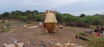

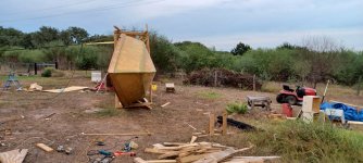

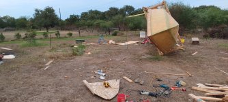

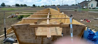

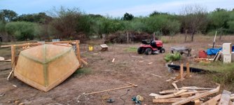

Bulkheads and stringers added, hull crated up and flipped. Mower in the back serves as a brake to keep the hull going over too fast and too hard; seems to have worked well. No damage (that I can see), except to 2x4.

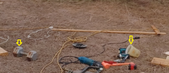

53,354
Oooohhhh
easter eggs..... dumbells and resin kicked in a bucket....
Harkonnen
Mar 29, 2022
123
Oooohhhh
Fair. Except that it is no resin, it is a used resin bucket I store screws in. And it's no dumbbell, it's a weight for holding things in place. :) There is also a demoted barbell weight somewhere, serving the same purpose.
I would think I'd catch cr*p for tools on the ground first, though. :D
