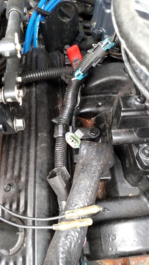

OK, looks like we found the problem. Thank you for your help fun times and everyone else who added suggestions . I found the diode and it does have continuity both ways , so its bad. While I was at it I found the hidden fuse. It too was blown. Its a 20 amp on my boat. I am trying to upload the pictures I took. The red one is the diode verified by looking up the number supplied by fun times and the exact diode popped up on a parts search. It doesn't look like any diode I have ever seen. I'm having problems uploading my photos but I will figure it out to help others. Thanks for your patience.

Sorry for taking so long to get back with my boat problem. I was finally able to get out SAT & Sun between weather and work. The boat ran great and I wish I could have pinpointed the problem 100% but since my nearest lake is 20 miles away, I did several things before trying her out. When you start looking for problems you start finding them. I found the 20 A fuse on my engine blown that I never knew about. I`m still not sure what its for. I also found the red diode allowing current both ways so I replaced both. The explanation for the diode is on a previous post on this thread. I also found my metal air filter very dirty and cleaned it as well. I removed my fuel tank vent line and blew it out with air. Between these several things the problem was fixed. I hope this helps the next guy somewhere. I`ve not been able to upload the pics of the diode or the fuse on the engine but would be happy to answer any questions that anyone may have about them in the future. It keeps telling me my photo is beyond the size limit but I`ve seen people post many pictures of their boats. It also says invalid file when I try uploading the second way.

Looks like I figured a different way to post my pics. You must click on the link . The red plastic one is the diode. Forward of that you see a disconnected connector kinda green. That's the connector that when opened has a 20 amp fuse in it. I still don't know what that fuse is for, but in my case it was blown. Hope this helps someone in the future.
