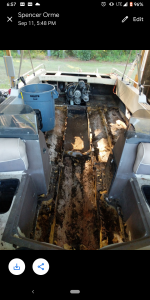

Thanks! A good deal of what I've learned is from boatworkstoday's YouTube page. He's a great teacher and he is ultimately why I decided to go with poly. He does a few comparison videos you may be interested in watching. Showed that chop strand and other mats are help together with styrene and poly has styrene in it and it breaks down that styrene and absorbs really good into the mat. Layup was a noticeable difference. I really wanted to use epoxy until I saw that, the price, and another strength test video he did. I'm definitely elbow deep at the moment! Pic attached
I have seen his video's
He does very respectable work, and informative too.

I looked at your pic and chuckled under my breath.. About all the several 100's of projects that I have seen, seem to almost have the same look.. including both of mine.
