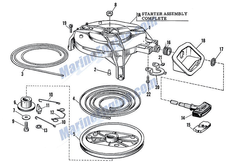

J15RENM I pulled the starting cord, hear a snap. Cord does not return. I can rewind manually. How to fix?
909
Jul 19, 2021
537
Those pesky 92 ( and older ) recoils are so fragile compared the 93's and up.
And it's almost always the spring.
If you're lucky, ( and the spring didn't break) it may just need to be re-assembled.
If it did break at either end, and not in the middle, and you're creative enough ... you might be able to re-use it.

Mech friend heated and bent the spring at inner end and reassembled unit so I could re install. Fixed now. Thanks for all replies and videos.
