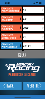

Could your feed signal be off ? Or a bad ground ? 7k would be the gauge pinned max perhaps? Is it ? That will tell a story. If she was doing 7k for real. You’d know all about it for sure.
Give me 2 secs and I’ll show you the maths on how crazy 7k would show. If it was real.

Your upwards of 33/34% prop slip if your numbers are right. So either your tacho is wrong or something us slipping badly in the drivetrain.
