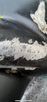

Okay, I found the number it's 48 73138 A40 14P

airshot
Jul 22, 2008
6,652
Bad prop, bad prop hub, motor mounted to high, faulty tach reading....those are your choices !! At 7K rpm, you should be well over 31 mph....gps confirmed speed ??
My guess would be spun hub or faulty tach reading...fact is your engine won't last long unless you figure it out quickly.

Tach is fine, I only tested the engine once after a 3-month rebuild of the boat. Engine does not have many hours, compression tested both cylinders at 160 PSI, no variation. The engine should only run at 5300 RPM, not 7000, so my opinion based on some research that the prop is too small at 10.25" x 14 pitch. It should be around 12" x 15 pitch; I'm looking for other opinions or people who have a similar setup and what they are using.

One ince of pitch equals about 200 rpm...so to drop from 7K down to 5300 rpm means an 8" change in pitch.not gonna happen, still willing to bet the tach is off or a spun prop. Can't believe your engine stayed together at 7K rpm......
