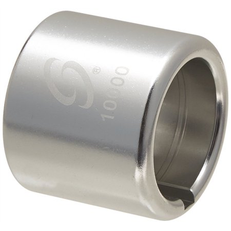

or pull the damper and use a crank socket
https://www.walmart.com/ip/Sunex-In...54493&wl11=online&wl12=34052250&wl13=&veh=sem
