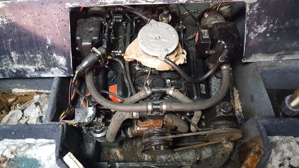

There, I think I was able to successfully load a picture of the boat engine. As you can tell there is a lot of condensation on the outside of the engine itself. This picture was taken while it was thawing out in the heated garage. Then it went from the garage to sub zero temperatures. I'm thinking that water could have gotten in somewhere and froze things up internally. At least I am hoping that is the case.

That picture shows how the boat was left out in the open over the weekend. Does it look like water could have gotten in somewhere and frozen internally?
