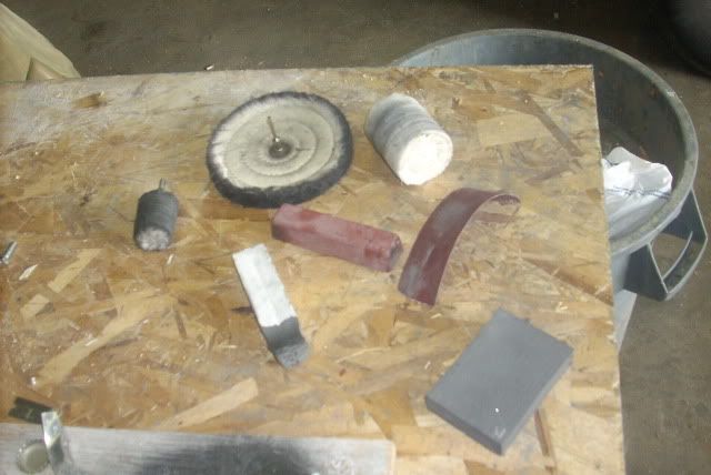

I repair towers from this all the time...
It really depends on the amount of damage.....getting the bugs off is easy.....warm water....wait.....wipe.....repete.
as far as scratches.....use rouge polish....and a drill buffer....shines like a mirror in minits.
this is a pic of an aluminium window frame from 1969 that had never been re finished....the upper oxidised is un touched.,...the shiny part is just finished.....kinda like before and after
the tools

clean first THEN polish.... his polish is the red bar in the pic.... any brand will work about the same tho they come in various grades. Some will cut faster to remove heavy damage and others give a better finish...

12,932
Re: Please Advise... Cleaning Waketower.....
thanks smoke......you are correct about clean then polish. and about the stick....
the stick is a metal polish called rouge.
it comes for just about every type of metal.
if you wash..with standard soap and water....or even windex.....wet the bugs first....then wait till the water softens them...then just wipe them off.
then ....after the rack is clean......
take the polish ...apply it to the buffing wheel....and start a buffin.... !!!.
because your tower is allready shining...it will only take a few minits to do an area.... it will come up great.
