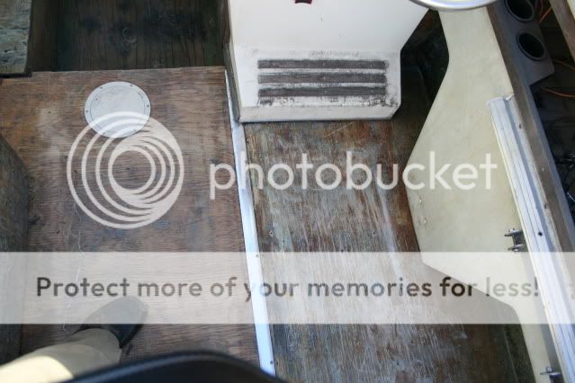

This thread has confused me... Does epoxy seal the floor? Does paint seal the floor? What can I use to seal the floor!! so that it will last. I plan to seal the underside too BTW.. the ski compartment was the epicenter of the last floor's rot and i imagine that the previous owner did NOT seal the exposed wood and that rotted the compartment and the water soaked into the floor and almost all the way to the edges. So what do i use to seal my new floor once and for all.
BTW -- just an update -- I am currently removing hundreds of pounds of soaked foam and rotted wood :D

Lots of things "seal" the floor but with differing degrees of longevity. Here are things that can seal the floor from best to worst:
- Fiberglass and resin (poly or epoxy)
- Epoxy resin alone (poly resin is worthless without glass, epoxy is fine)
- Marine spar varnish
- Quality porch and floor paint
- Crayola watercolors
