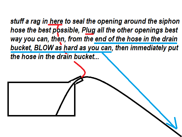

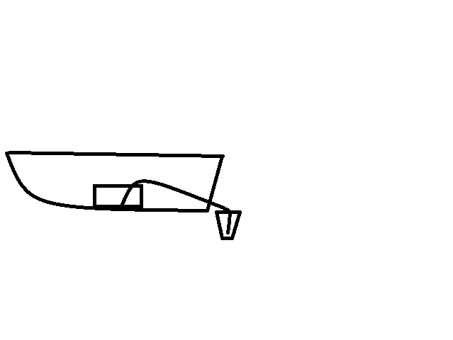

You can siphon out the fuel and oil or remove the tanks, you'll probably need to remove the tanks anyway... but that also might be easier to do i9f they're empty.
