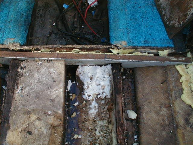

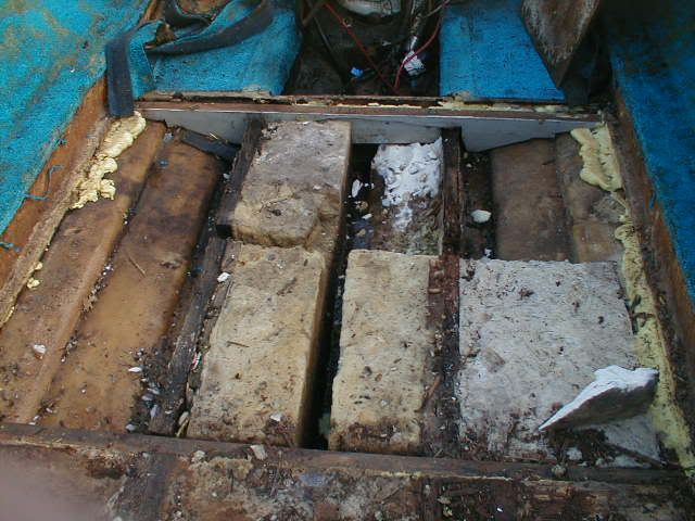

Here are some of the initial pictures with some of the decking removed.
The first one is what I found after removing the deck: Was surprised to find 3 "saddles that were built to support the deck and notched into the stringers.

This one is looking aft and you can see one of the "saddles" that was built and notched into the stringers.

Obviously, I need a little practive posting photos and links but here's the start.
