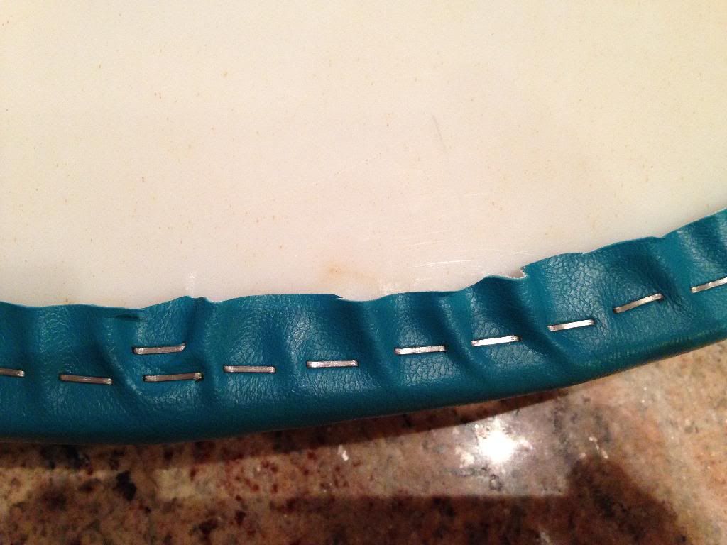

Hey Brett,
Just wanted to let you know I got my pneumatic 20 gauge wide crown stapler from harbor freight in the mail and tried it out. Worked like a charm. For $20 its a no brainer... Here's a pic of what I got done today...
Figured I'd show off my sewing skills.. .or lack thereof lol!
