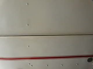

I have been reading here for months trying to gather information on leaky seams. I am a girl and have no fiberglassing expierence ( or tools willing to buy ). The fiberglass problem is on a scamp trailer not a boat ( it is fiberglass. I think it was made by chopper gun matt and then the 2 hulls are fiberglassed on the inside .) Even though it is not a boat will you guys give me advice on how to fix. Please please please
If so, here is my problem. It is leaking at the seam. I want to :
1) Epoxy peanut butter on the outside of the trailer seams to prevent water from getting into trailer.( like yachtdr did)
2) Fiberglass on the inside seam if the fiberglass is damage from the water.I do not know if it is damage?
Here ar some links to pics. I cannot post pic yet.
Thank you for any help

OK, from what I can see, you basically want to seal the joint between the two sections...
First question, can you remove the entire aluminum trim strip???
If Yes, you can get some Marine type sealant...either 3M 4200 or 5200...and a cheap caulking gun...run a bead of the sealant both inside and outside of the affected area...use some Mineral Spirits to clean up any mess...wear some latex gloves, dip your finger in the mineral spirits, and smooth/work the sealant into the gap...there are two types of these sealants, a slow cure, which takes about a week to cure...and a fast formula which cures overnight...you can use either one...
IF No, you can just apply the sealant to the inside using a plastic squeegee of some sort and make sure you squeeze enough into the gap to provide a good seal...
As an added precaution, if you feel the need, you can apply a bead of sealant to the back of the aluminum trim strip, also...
Hope this helps...ask more questions if you need to...

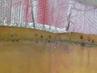

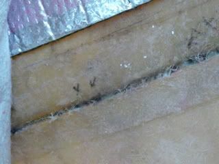

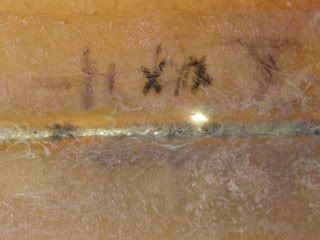

i thought about using sealant on the outside seam under the aluminum but i have read here that it fails. I thought the peanut butter worked better. i just dont know if i have enough room to use epoxy peanut butter in-between the hulls. If not i will use the sealant in between the hulls. ( i will put sealant on top of the aluminum either way).
On the inside i thought i have to fiberglass if that glass is bad.That is the only thing bonding the two hulls. If the glass is not damaged then i will seal from outside . Hoping it looks fine to you guys :)

GT is correct on the sealant. 3M 4200 is what I'd recommend. On the inside, I'd use some Poly resin and some 4" fiberglass tape. Should be able to get some @ Lowe's or Autozone. Mix according to instructions, use cheapo Chip brushes to paint on the resin then apply the tape over the seam and brush on more resin to saturate it and smooth it out It'll set up in 20 minutes so mix small batches and do about 5-6 ft at a time. It won't leak anymore.

Sand with 60 grit, Layer of Mat and then the Cloth tape.

Hello BT and welcome to Iboats :) ..
Ok..here is what I would do.
1. remove the alum trim.
2. Dig/scrape ( with a flat head screwdriver or putty knife kinda thing ) the seam to remove all the crapola in there.
3. Because you dont want to buy tools your going to have to prep the seam by hand..so get some 24-36 or 40 grit paper and really scruff the heck out of the seam as far in as you can. Try to round the joint edges a bit. ( using a die grinder you could just zip around the flange/seam in 30 mins..but by hand it might take a few hours ).
4. Try to blow out the seam or take a broom and really try to clean all the dust out of the seam.
5. Acetone wipe the seam Real good.
6. Tape off the upper and lower sides of the seam ( were you dont want the putty to get on ).
7. Mix up some Epoxy and Cabosil and Pack the seam. Work it in there as deep as you can... I mean really Cram it in there. You can then just screed off any extra flush with the flange edge.
8. Pull the tape off before it cures. Leaving a nice clean filled flange joint.
9. Reinstall the Alum trim.
Done on the outside..now the inside..
1. Go around and mark all of your bad glass spots.
2. Scuff/sand about 4" beyond the affected areas.
3. Acetone wipe clean.
4. Put down a few layers of 1.5 oz mat and epoxy ( left over from making your putty ).
4.b. You can use Poly and the mat..but its gonna get real stinky in there.
That should cover it :) ..
Good luck and any more questions .. fire away..
YD.

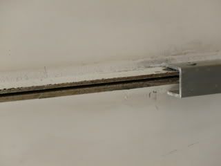

I have realized that I do not have the skill/confidence to fix the outside by grinding into the joint. Some parts of the 2 flange's are very close (tip of screwdriver barley goes in). Im not comfortable grinding in those areas. So I will fix by glassing in the inside as you guys describe. I will use poly resin that way if I mess up i can take it to pro.
But since I have the outside seam exposed,the areas where the flanges are father apart( I can get to ) is where it leaks into the trailer, can I put something on that area?. It looks like dry fiberglass not enough poly resin was used.
After google searches can I put: ( without contaiminating the fiberglass i am going to poly glass later inside)
1) finishing poly resin just to coat dry area
2) captain tolleys creeping crack cure (might run into areas i cannot reach :)
3) smear with 3m 4200
4) anything that you guys know about that I dont
I will put the aluminium rail back on per the instruction given. This may stop the leak long enough so I can practice glassing , grinding and sanding on scrape wood this summer before glassing inside.
Thanks for any advice
Bt
Yacht Dr.
Feb 26, 2005
5,581
Re: New here leak at fiberglass seam
You could always just calk the outside seam after cleaning with some fast cure 4200 or 5200.
You should not have any leaks after you glass the inside properly :) .
YD.
oops!
Oct 18, 2007
12,932
yeah.......either one of the two ways will work.
its just a seam.......same as a flange joint on a hull.......4200 will do it....that is the cheap fix.....if done correctly....will last for many years.
if you epoxy and glass it ....its forever.
