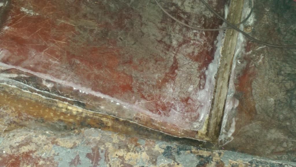

Here is a picture of the flotation chamber, stern, starboard side. I've gotten the foam and old wood out and ground most of the fiberglass down. There is a groove about 1/4 inch where the original box was. Should I fill it in and build a new box? If so what do I use to fill the groove in? Or do I build the new flotation chamber into the existing groove? Any other advice is appreciated!

The Tin boat guys use it all the time. Not sure what you would use it for.
I'm also interested to know where you want to apply it.

Yeah, I'm getting a bit confused too. The Proper way to seal a Fiberglass boat deck is the coat the bottom section with resin and then apply one layer of CSM. Then do the same on the top except apply 2 layers of CSM and then you can Paint it. If You only want to tab it to the hull side land then polyurethane it and paint it, I'm afraid it won't last very long. You could thoroughly soak it in some wood sealer and then paint it after tabbing it and then paint it and it would last a lot longer but decks get a lot of water and abuse and IMHO it's a lot better to Glass them. But Like I always say it's your boat and you're free to do with it as you see fit. This link will give you some good info...Fabricating Decks, Stringers, and Transoms

My plan was to seal the deck with the spar urethane, then paint. The flotation chamber was going to get glassed since it's at the stern and close to the bilge. I have the foam already. However, if enclosing the deck in fiberglass , then painting is the better route I will do that. I figured the deck will see less water, but I've been wrong before.
