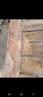

Well it's been a while since I posted because of the winters and colder weather I could not do much. But I'm back at it again and found a few trouble spots that will need to be repaired. Have a little more grinding and sanding to do and getting close to cutting out my transom. Question I have is how much glass is to much glass to remove, I question this as I don't want to take down to much by the stringer channels that the stringers sit in. I will post some more pictures tonight. Headed full force this summer and due to weather I am able to start much earlier.

I Cant grind them down flush with the hull as they are actual channels where the keels are under the boat. Just not sure do i need to take the glass alll the way down to the transparent looking colour or just rough the old glass up

Yep, my stringers lined up with my strakes as well...you can still grind it all the way down. Here's a picture from when I was rinsing out the inside after grinding. You can see where the strakes are - this is where the stringers were.

This is what I have right now. Also wondering along the sides of the channel it looks like rotting wood is that just discolored fiberglass from the rotting wood ?
