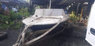

Actually we got it up to about 55 ish mph or around 90 km/h ohh and here’s some pics of how it looked then and now although I haven’t throughly cleaned it and a video of me turning the engine with its own power FYI it doesn’t have spark plugs cus I removed them and cus there seramic were all cracked and haven’t found one yet oh and what batteries do you people run this on ???
