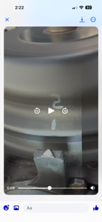

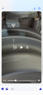

The air mixture screws were set to 2.5 turns out , motor will not run . If I spray starting fluid . A tiny amount ( washes out the walls ) it will fire . So that told me gas issue . Took carbs off double checked , all good . Checked spark blue . So figured air screws . So they are turned out 4 turns . It idles it idles at 900 rpm in a garbage can of water . Timing is spot on . Have marked cyl 1 & 2 on fly wheel. And used timing light to
Show they are firing properly.

Thank you for the reply’s. No matter what I do I can’t get this to idle nicely or even good . It is a 2 stroke . lol. I looked under flywheel seal is not leaking . I have had the motor running and sprayed carb cleaner around motor looking for vacume leaks . Motor never sped up . The timer base and stator read fine with ohms . So you can only rebuild the carbs 10000 times . lol. So the only thing I can think is possibly the charge coil or stator are
Failing intermittently .
Timing shows perfect for TDC CYL 1. I marked CYL 2 on flywheel. That one shows firing on time.
Did the Joe Reevs WOT shows up at 19 degrees as it should . So anyone want to shoot a good idea of what else I am missing . I am hoping to get this resolved .
