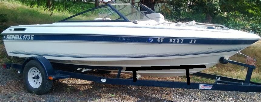

Okay so it looks like I am going to have to remove the cap. Ive read that I am going to have to take measurements before doing so but what do I need to take measurements of? Also do I need to build something to hold the hull in place or will leaving it on the trailer be fine?
Looking at the stingers theres only one set and only 2 bulkheads before and aft of the fuel tank. The strings run from the bow of the boat to about where the steering wheel is. Should they run the full length of the hull or am I mistaken? Also should I keep the original design or add more stringers and bulkheads?

Measure from port to starboard at the deck height and the top of the hull sides on the inside. Mark the sides of the hull @ the Deck Height. If your trailer is a Bunk Style trailer you can prolly leave it on the trailer and add some additional supports. If it's a roller style then you'll need to either build supports on the trailer or take her off the tailer and build a cradle for her to sit on during the rebuild. I'd recommend putting her back exactly like she is now, only with better glassing. No need for additional Stringers or Bulkheads. Pics of the boat and how she sits on the trailer will help us to tell you what you need to keep her supported for the rebuild.

If you could fabricate some supports to attach to the trailer that would support the bow area as shown You could prolly leave her on the trailer. Using some nylon straps around her girth would keep the sides from spreading.
