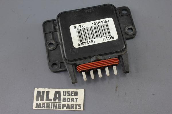

Achris in regards to Mefi 1, did merc use a knock module, not to be confused with a sensor.
Tail_Gunner
Jan 13, 2006
6,237
It appears so, Bup lays it out quite clearly. Or maybe I have had one to many knocks myself...Quite possible
do not remember the timing curve for this engine and I'm almost 100 % it is not listed in the service repair manual. I have the manuals for this but not in front me to 100% verify that nor looked at it in a while but I am pretty sure it is not listed. If I get time, I will pull the service manual out to verify this.
Like I said MEFI 1 & 2 used EXTERNAL knock sensor MODULES and all Knock sensor(s) are external. On MEFI 3 NO EXTERNAL Knock Sensor MODULE was used as its bases / circuit is within the MEFI 3 ECM. Also like I said L29 Big blocks used 2 Knock sensors and had 2 dedicated connectors thru pin connector J1/30 and J1/14.- FYI J1/30 pin connector was for KS # 1 and if only one KS was used.
If you have a Knock Module you have MEFI 1 or 2 NOT MEFI 3. These ECMs MEFI 1 & 2 looks exactly the same but MEFI 3 looks totally different is more square and smaller dimensions.. His app is MEFI 3 - with one KS and NO Knock Module. I would triple check to make sure your BWD - KS is the correct one for the MEFI 3 / 502 app but heck you can not even go by the BWD catalog as it is listed wrong.

Finally found the seperate knock module. Look closely at that part, do you have it mounted on your engine near the ECU. Based upon that engine switch over you cannot assume anything.
In regards to your distributor I see a Delco product when merc used a t-bolt. Can that be done with a Mefi system?

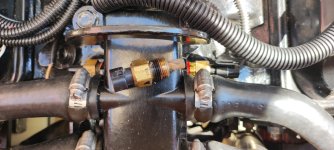

Or engine temperature sensor item number 17, https://www.mercruiserparts.com/bam/subassembly/31880/2338/70
Fuel psi from a bad regulator? yes it could be too but the fuel pressure should really be checked first so you know what the fuel psi is right now and then after a new regulator should you decide to buy and install one just because you've been running down this road already it seems.
Make sure the engine temperature is truly reaching 160 degrees and sensor # 17 sees it reading right on a marine scan tool...Not the dash gauge as it's a different sensor than the ECM sensor.

Many thanks for your suggestions.
Bought and replaced the engine temperature sensor last weekend (picture 1), had already replaced the distributor sensor last year and finally bought the map sensor and will be replacing it also next week.
Engine started effortlessly, was idling perfect and the response to the throttle was immediate. I'm sure the rpm were certainly higher than what I used to hear up until now. Nevertheless black smoke was still coming out of the exhaust, maybe the exhaust is filled with smoke and will clean eventually, who knows? (picture 2 is taken while on idle). I can't tell if excess fuel is sprayed by the tbi as I have never seen another, took a video but I can't find a way of posting it here.
Borrowed a fuel pressure gauge to measure the pressure but the kit didn't come with the correct banjos, will make some on the lathe. The throttle body has two fuel inlets (picture 3), one with a plug (smaller diameter) and another where the fuel line from the fuel pump goes. Should I measure the pressure straight from the fuel pump? What reading should I have? 30psi? The other inlet with the plug is to measure the pressure after the fuel pressure regulator on the throttle body? What reading should this have? Should I disassembly the fuel regulator and replace gaskets/check condition?

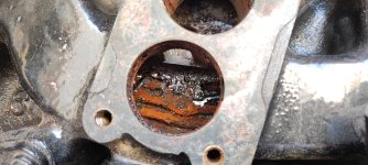

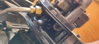

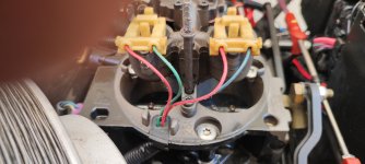

Took the throttle body and the adaptor assembly off to replace the gaskets and noticed rust marks inside the intake manifold, is this usual? Please take a look at the pictures...
Many thanks,
