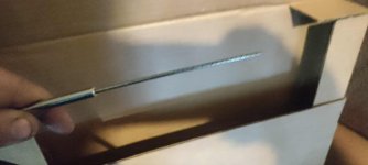

The other difference is that instead of a coated inner wire with a metal sleeve on the end, the wire is uncoated with no cap, yet smoothed on the outside:
I used to do a lot of bicycle mechanic work, so I'm used to dealing with un-coated cables. Just grease the snot out of them and they do OK. Given that the metal sleeve on the Quicksilver cable banana'd on me (and likely a good part of why I was having binding), I'm calling this an improvement for my specific situation.

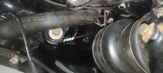

Speaking of the cable, I did some looking and it seems the original (to me) cable routing wasn't correct and likely another cause of the binding. Here's what I have currently:

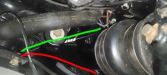

That's not super clear, so here's the old and new routing drawn on top:
Red is the old routing... took a hard 90° bend coming out of the transom and ran between the transom and the Y-pipe. The new is in green; the bend is a lot less severe by running between the Y-pipe and the flywheel cover. I did notice some reduction in cable resistance with the new routing, so I'm rolling with it.
