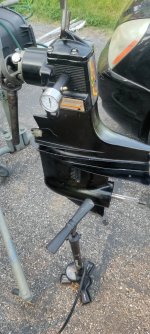

Speedy sleeve came in. Drive has been assembled and is currently pressure testing. Holding 12psi for 40 mins and counting. Edit: I've since rotated the shafts and pressurized up to 17psi. We shall see how it goes.
I'm supposed to receive the replacement bell housing gasket/seal kit tomorrow (yes, MC-1 is a different gasket... Better safe than sorry). But first I'll need to do bellows and shift cable. Yay 😔

Called it at 15 minutes... seems to be sealed well. I'll fill it with oil and grease the u joints before it goes on.
