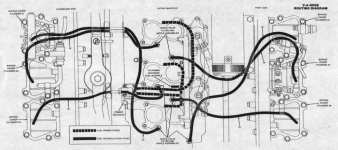

Hi can anyone explain or show a diagram description of fuel hoses vacuum hoses primer hoses etc

Thanks is there a search function on this forum for relevant service manual images to confirm the routing of the fuel recirculating system and vents ? Out of the manifold and crank case and how they all tie into the oil and fuel pumps

Yup you are correct, and pics/manuals will make you understand better. They will provide specific diagrams to your engine.

2 lines come of fuel solenoid that prime carbs
1 line comes off fuel solenoid that feeds carbs
1 line comes off fuel pump that feeds carbs
Each carb has a recirculation line that feeds unfired fuel in a loop from top to bottom sump.
